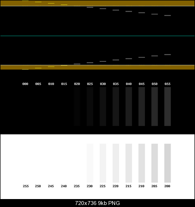

  7. Originally Posted by Kdmeizk View Post
    Thanks jagabo. So, if I work for VP9 codec, I suppose that your link for MPEG isn't for me ?
    It's a video with known good SD rec.601 levels (HD rec.709 has the same levels for greyscale). If your computer doesn't play that back properly (see the post with the DV version of that video for how it should look) it is set up incorrectly. Once your system is set up to display video correctly you can start looking at encoding videos yourself and analyzing where problems are occurring. You can use that MPG video as a source for testing with VP9.
    This is where Histogram() or VideoScope() come in useful. You can verify that your YUV video has the correct levels and colors without worrying about whether your editor or graphics card is converting to RGB properly.
    ffVideoSource("levels.mpg")
    TurnRight().Histogram().TurnLeft()

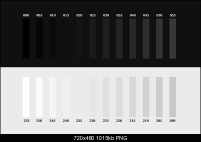

    For example, with this image:
    you should be able to differentiate all the bars except 235 (it's the same brightness as the background). The 15 bar may be hard to see since it's only one different from the background (16).
